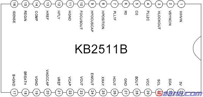

3.引脚功能
引脚 |
符号 |
功能 |
1 |
H/HVIN |
TTL compatible horizontal sync input(Separate or composite)行同步输入端 |
2 |
VSYNCIN |
TTL compatible vertical sync input (for separated H&V)场同步输入端 |
3 |
HLOCKOUT |
First PLL lock/unlock output (0V unlocked - 5V locked)一级锁相环状态确认输出端(0V:没锁定-5V:锁定) |
4 |
PLL2C |
Second PLL loop filter二级锁相环回路滤波端 |
5 |
CO |
Horizontal oscillator capacitor行振荡器外接电容端 |
6 |
RO |
Horizontal oscillator resistor行振荡器外接电阻端 |
7 |
PLL1L |
First PLL loop filter一级锁相环回路滤波端 |
8 |
HPOSITION |
Horizontal position filter(Capacitor to be connected to HGND)行中心滤波端(外接电容到行模块地) |
9 |
HFOCUSCAP |
Horizontal dynamic focus oscillator capacitor行动态聚焦振荡器外接电容端 |
10 |
FOCUSOUT |
Mixed horizontal and vertical dynamic focus output行场动态聚焦叠加输出端 |
11 |
HGND |
Horizontal Section Ground内部行模块地 |
12 |
HFLY |
Horizontal Flyback Input (positive polarity)行反馈输入端 |
13 |
HREF |
Horizontal Section Reference Voltage (to be filtered)内部行模块基准电压滤波端 |
14 |
COMP |
B+ error amplifier output for frequency compensation and gain setting B+误差放大器输出(用于频率补偿和增益设置) |
15 |
REGIN |
Regulation input of B+ control loop B+控制回路的调节输入端 |
16 |
ISENSE |
Sensing of external B+ switching transistor current or switch for step-down converter B+电流感应端 |
17 |
B+GND |
Ground (related to B+ reference adjustment)地(与B+基准调节有关) |
18 |
BREATH |
DC breathing input control(Compensation of vertical amplitude against EHV variation)瞬间直流输入控制端(高压变化对场幅的补偿) |
19 |
VGND |
Vertical section ground内部场模块地 |
20 |
VAGCCAP |
Memory capacitor for automatic gain control loop in vertical ramp generator场锯齿波发生器自动增益回路的外接存储电容端 |
21 |
VREF |
Vertical section reference voltage (to be filtered)场模块的基准电压滤波端 |
22 |
VCAP |
Vertical sawtooth generator capacitor场锯齿波发生器外接形成电容端 |
23 |
VOUT |
Vertical ramp output (with frequency independent amplitude and S or C corrections if any). It is mixed with vertical position voltage and vertical moire.场锯齿波输出端(有与频率无关的幅度和S/C校正),含场中心和莫尔效应校正。 |
24 |
EWOUT |
Pincushion-East/West correction parabola output东西枕校抛物波输出端 |
25 |
XRAY |
X-RAY protection input (with internal latch function)X射线保护输入 |
26 |
HOUT |
Horizontal drive output (internal transistor, open collector)行驱动输出端 |
27 |
GND |
General ground (referenced to Vcc)供电地 |
28 |
BOUT |
B+ PWM regulator output B+脉宽调整输出端 |
29 |
VCC |
Supply voltage (12V typ)供电端(一般12V) |
30 |
SCL |
I2C clock input I2C时钟线输入端 |
31 |
SDA |
I2C data input I2C数据线输入端 |
32 |
5V |
Supply voltage (5V typ)供电端(一般5V) |

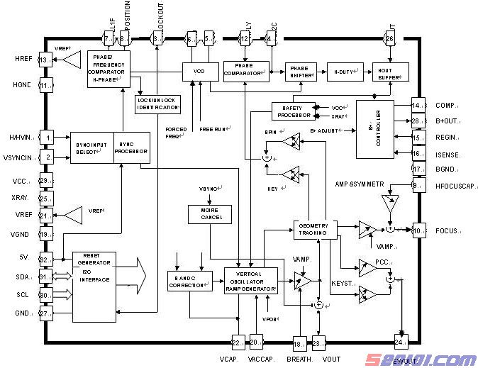

4.内部框图 [Page]
英文注释:
VREF-》基准电压,PHASE/FREQUENCY COMPARATOR/ H-PHASE-》相位/频率比较器/行-相位,
VCO-》压控振荡器,PHASE COMPARATOR-》相位比较器,PHASE SHIFTER-》移相器,
H-DUTY-》行占空因数,HOUT BUFFER-》行输出缓冲器,
LOCK/UNLOCK IDENTIFICATION-》锁定/没锁定 确认,FORCED FREQ-》受控频率,
FREE RUN-》自由振荡,SAFETY PROCESSOR-》安全处理器,B+ CONTROLLER-》B+控制器,
B+ ADJUST-》B+调整,SYNC INPUT SELECT-》同步输入选择,SYNC PROCESSOR-》同步处理器,SPIN-》旋转,KEY-》梯形,AMP&SYMMETR-》放大与对称,GEOMETRY TRACKING-》几何跟踪,VAMP-》场放大,KEY-》梯形失真,PCC-》枕形失真校正电路,
MOIRE CANCEL-》莫尔条纹取消,RESET GENERATOR-》复位发生器,I2C INTERFACE-》I2C接口,
VERTICAL OSCILLATOR/RAMP GENERATOR-》场振荡器/锯齿波发生器,
S AND C CORRECTION-》场S校正和场中心校正
