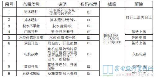

创维XQB70-51A全自动洗衣机故障代码
