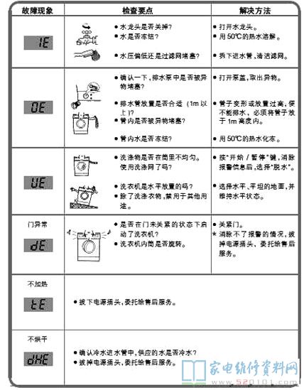

LG WD-C1222AD全自动洗衣机故障代码
