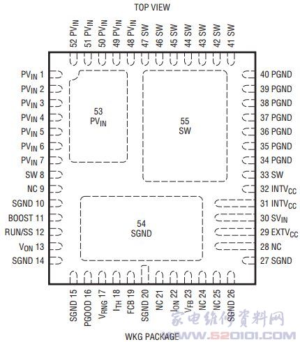

概述:LTC3608采用7mm x 8mm 52引脚QFN封装.
