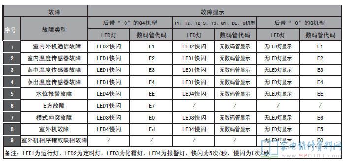

ELCO RM5.6G/E壁挂式空调器室内机故障代码
