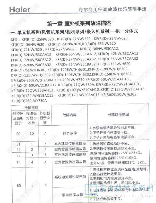

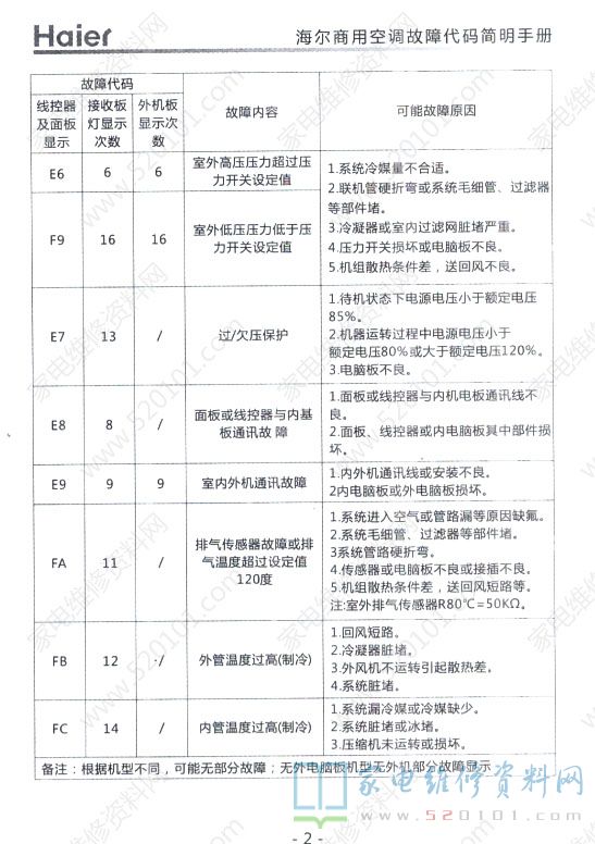

海尔KFRd-260LW/730A商用柜式空调故障代码
