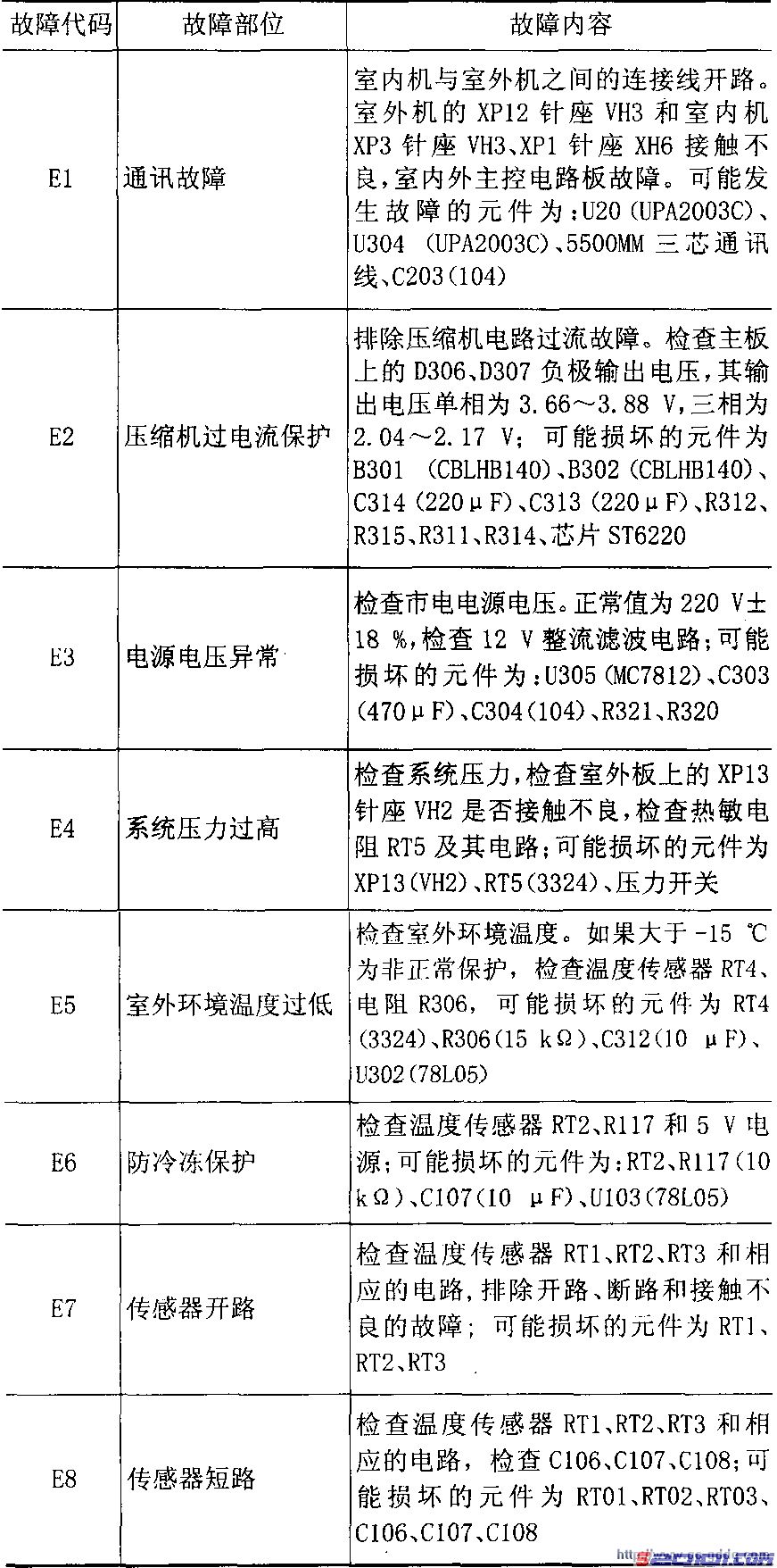

春兰KFR-140LW/Ads KFR-70LW/Bds KFR-40LW/d KFR-100LW/ds空调故障代码
2008-01-11
作者:
2352
春兰KFR-70LW/BP变频柜式空调故障代码
