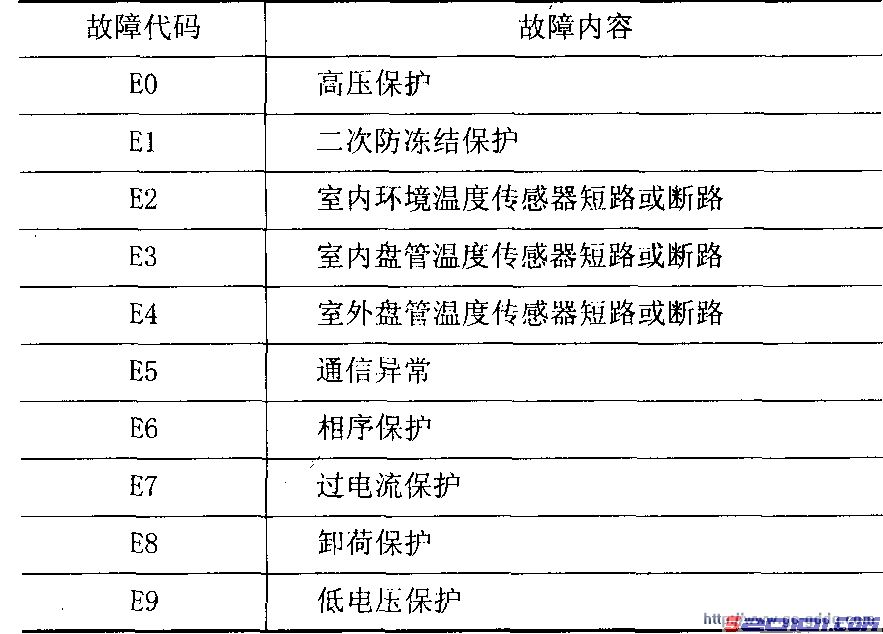

春兰KFR-140/S KR-140/S空调故障代码
