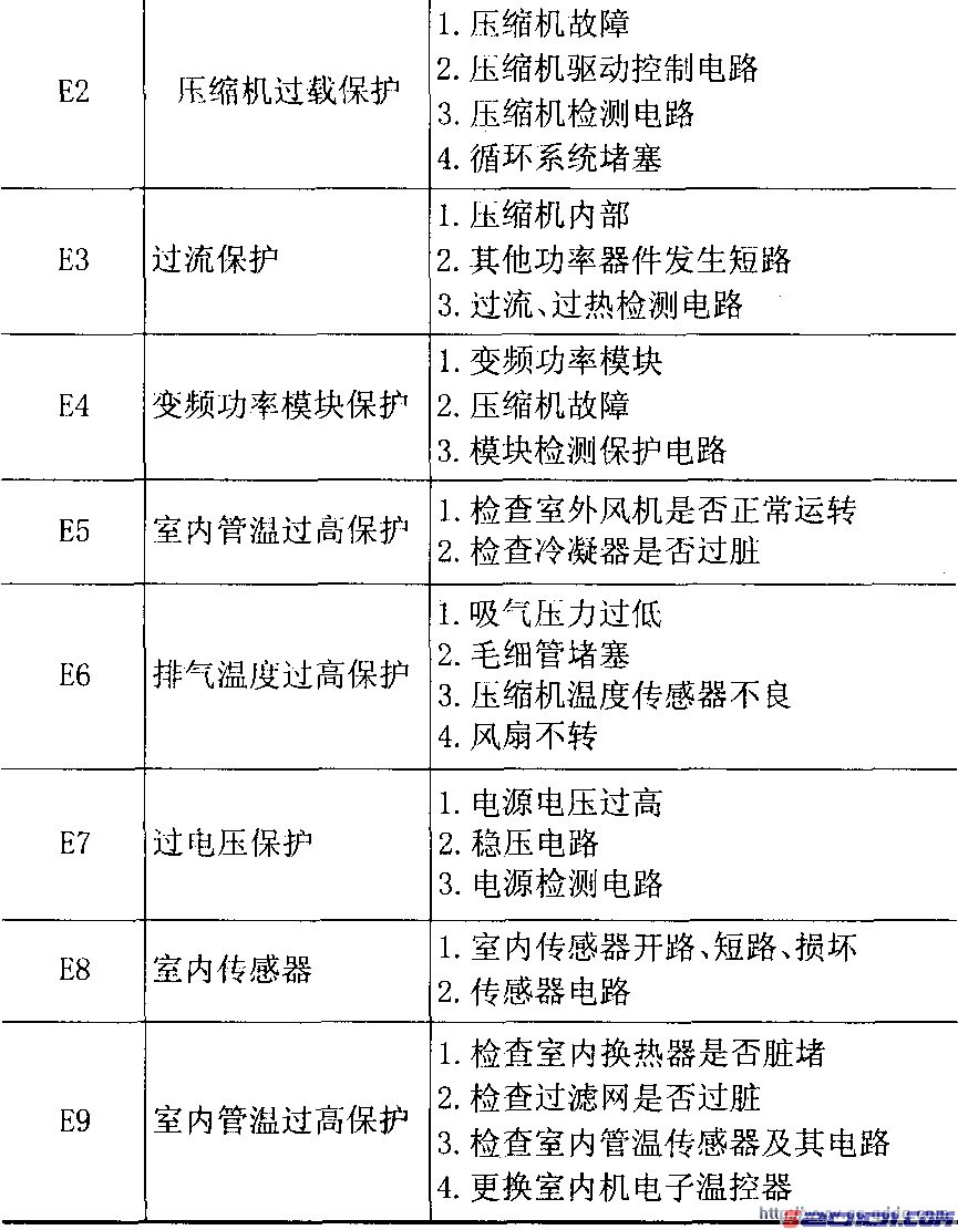

春兰KFR-70LW/BP变频柜式空调故障代码
