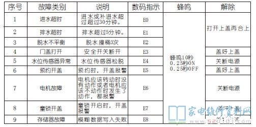

创维XQB52-21C全自动洗衣机故障代码
