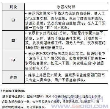

惠而浦XQB75-D7572CB洗衣机故障代码
