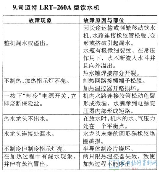

司迈特LRT-260A型饮水机故障维修
