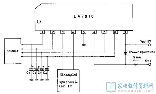

二、LA7910典型应用电路
三、LA7910真值表
| 输入 | 输出 | |||
| 3脚 | 4脚 | 1脚 | 2脚 | 7脚 |
| 0 | 0 | 1 | 0 | 0 |
| 0 | 1 | 0 | 0 | 1 |
| 1 | 0 | 0 | 1 | 0 |
