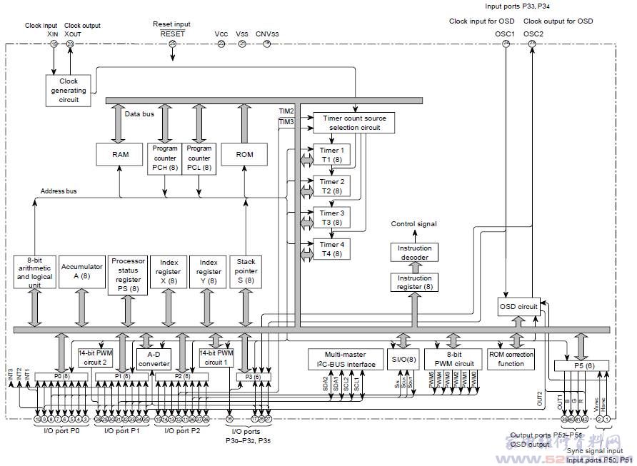

概述:M37225ECSP是日本三菱半导体公司生产的一款8位CMOS单片微处理器。它的内部采用了I2C总线控制技术,可以控制E2PROM、调谐器、SRS处理器、AV接口、VGA接口等,CPU外围电路主要包括:时钟振荡电路、复位电路、字符R、G、B输出电路、遥控接收电路及本控电路、静音控制电路、存储器读写控制电路。它的ROM为48K bytes RAM为2048 bytes。

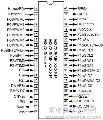

| 序号 | 引脚功能 | 电压 (V) | 序号 | 引脚功能 | 电压 (V) |
| 1 | H-sync | 4.12 | 2 | V-sync | 1.17 |
| 3 | VOLUME | 0.035 | 4 | LED/ACPOWER | 5.4 |
| 5 | VLF | 4.96 | 6 | VHF | 0.037 |
| 7 | UHF | 0.92 | 8 | WOOFER VOLUME | 0.033 |
| 9 | AFT IN | 4.5 | 10 | REMOTE IN | 5.0 |
| 11 | RESET OUT | 0.03 | 12 | SERVICE IN | 0.03 |
| 13 | SRS ON/OFF | 0 | 14 | AV1 |
5.0 |
| 15 | AV2 | 5 | 16 | V-TUNE | 3.5 |
| 17 | AUTO SOUND IDENT | 1.4 | 18 | GND | 0 |
| 19 | XTAL IN | 2.3 | 20 | XTAL OUT | 2.02 |
| 21 | VSS | 0 | 22 | VCC | 5.0 |
| 23 | OSC2 | 2.84 | 24 | OSC1 | 2.84 |
| 25 | RESET | 4.78 | 26 | STANDBY | 0.05 |
| 27 | KEY2 | 5 | 28 | KEY1 | 5.0 |
| 29 | PC/TV | 0.013 | 30 | SOUND MUTE | 4.96 |
| 31 | SDA2 | 5.0 | 32 | SDA1 | 2.1 |
| 33 | SCL2 | 5.0 | 34 | SCL1 | 2.5 |
| 35 | HALFTONE | 4.97 | 36 | BACKLIGHT | *4.99 |
| 37 | SIF2 | 4.98 | 38 | SIF1 | 4.48 |
| 39 | FST BLK | 0.27 | 40 | OSD-B OUT | 0.16 |
| 41 | OSD-G OUT | 0.1 | 42 | OSD-R OUT | 0.07 |
