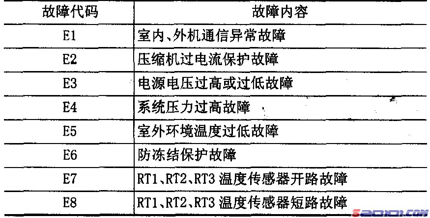

春兰空调KFR-40LW/D故障代码
2008-01-13
