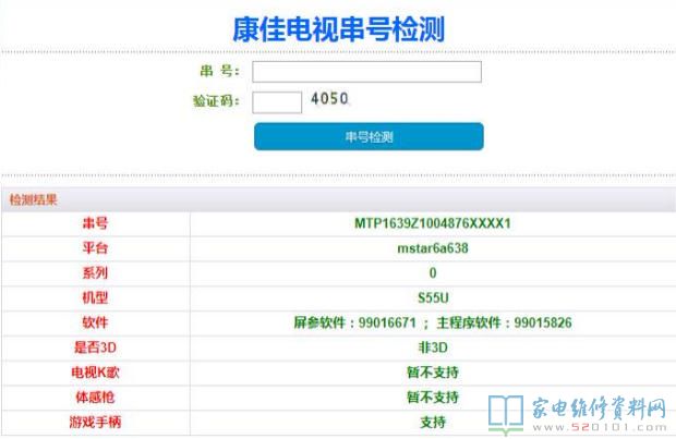

如何根据串号查平台:http://service.kkapp.com/KKAFTERSALE/pages/sn/sn.jsp
