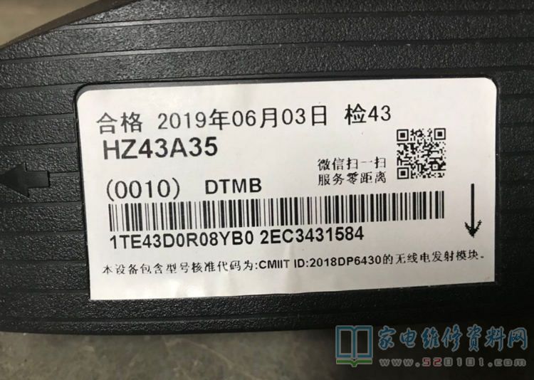

       刷机信息:HZ43A35/1TE43D0R08YB0 2EC3431584/HD425V1F71-TOK1\S1\ROH
